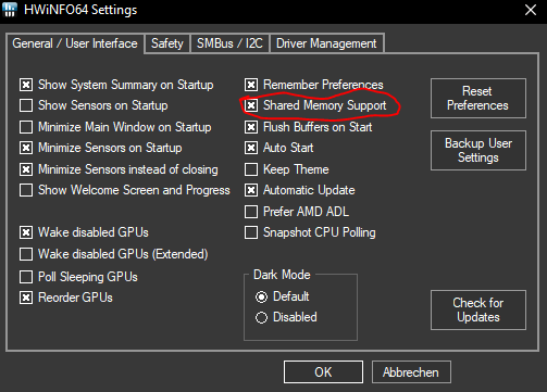

You have to enable "Shared Memory Support" in HWInfo 7.0. Since 7.0 this option is disabled by default. Without this function, Aquacomputer Service cannot read data from HWInfo.
HWInfo Tasksymbol -> right click -> settings -> check "Shared Memory Support" -> OK
Maybee after checking "Shared Memory Support" you have to resart Aquacomputerservice or the pc.
For me resarting the service worked.
HWInfo 7.0 changed this setting, because of new licencing. You can only run this option for 12hours. After this you get a popup to reenable this option. When you buy HWInfo there will not be a popup or a 12 hours limit. When your pc don't run longer than 12 hours, you will not have a problem, because the timer resets, when HWInfo is closed.

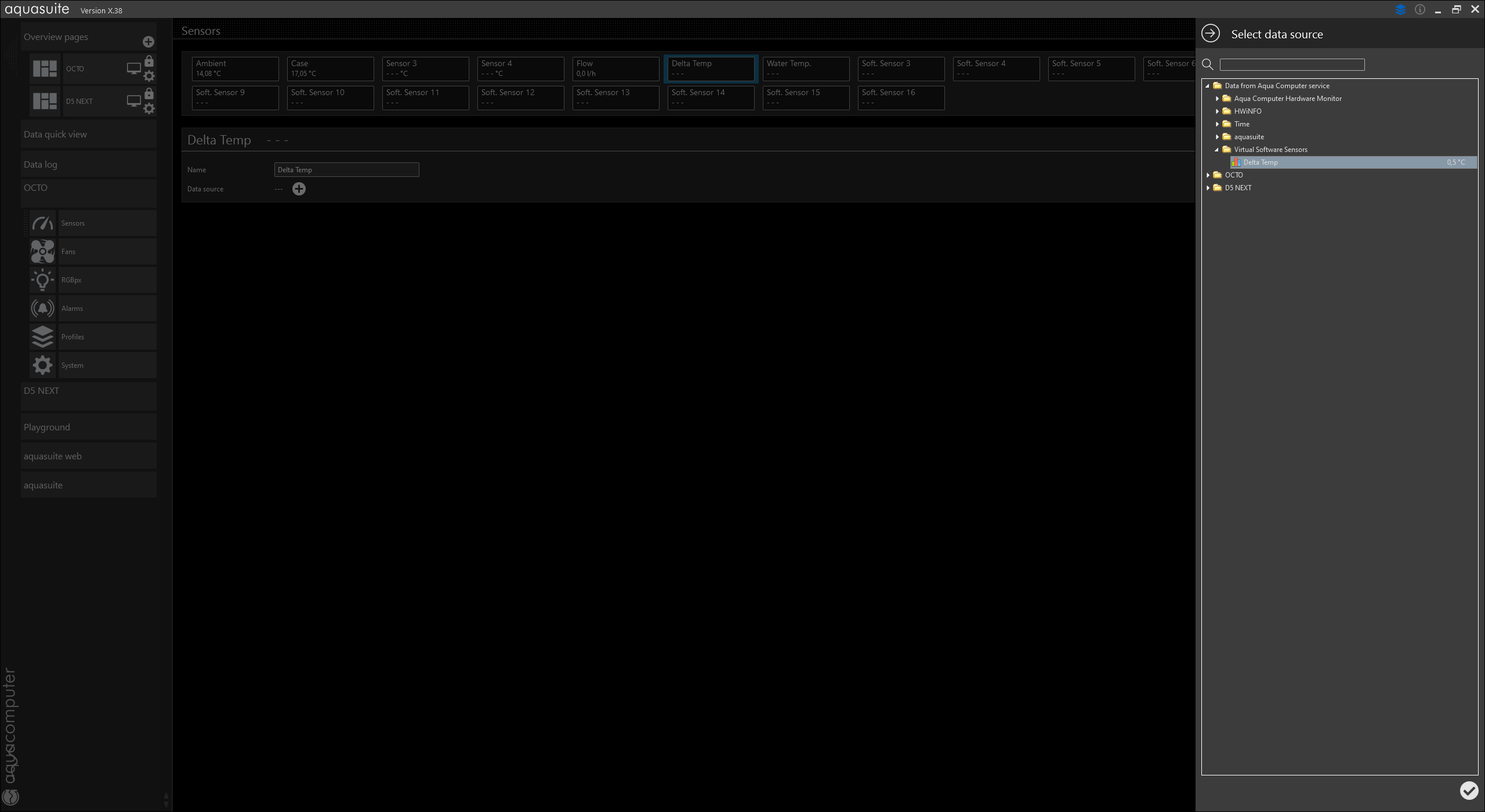

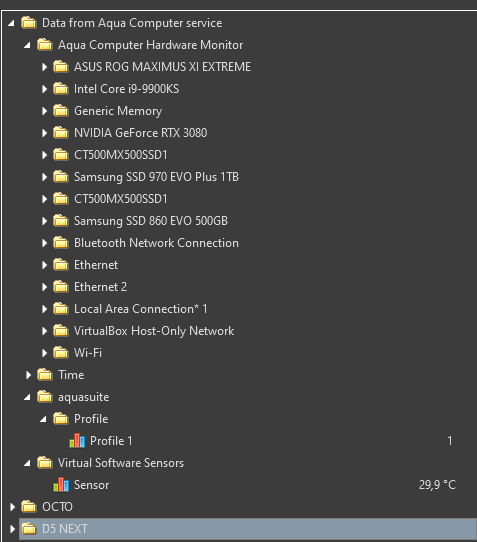

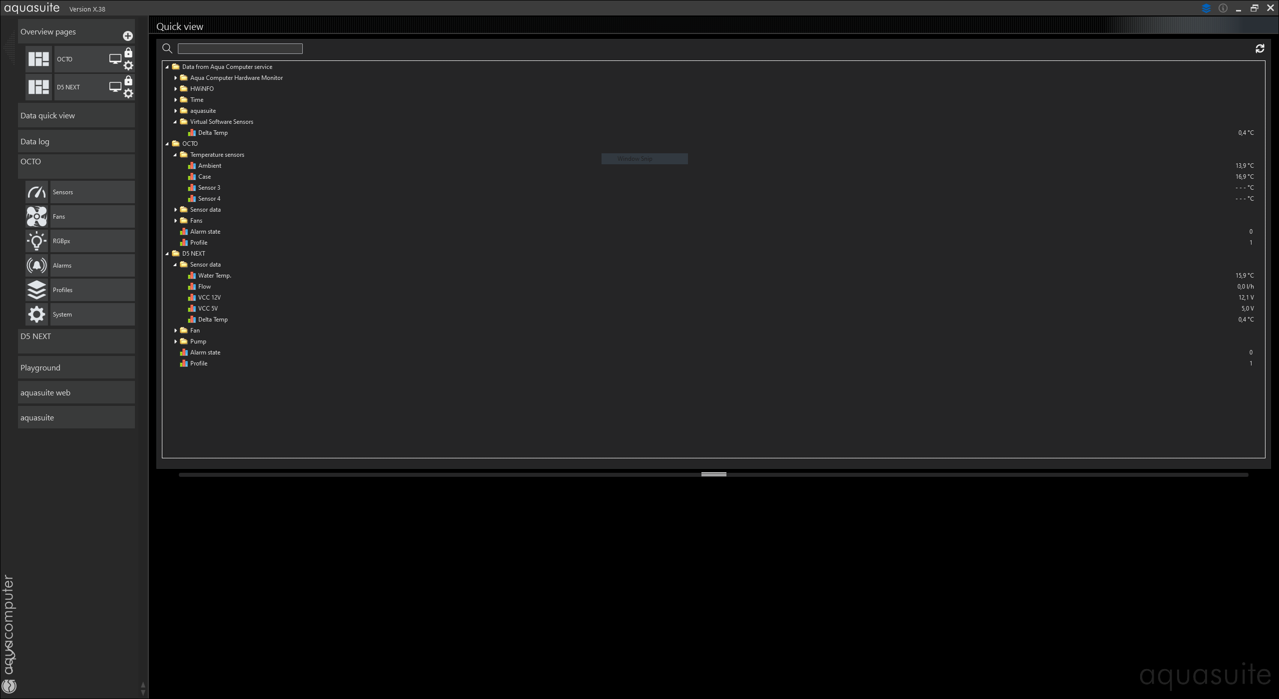

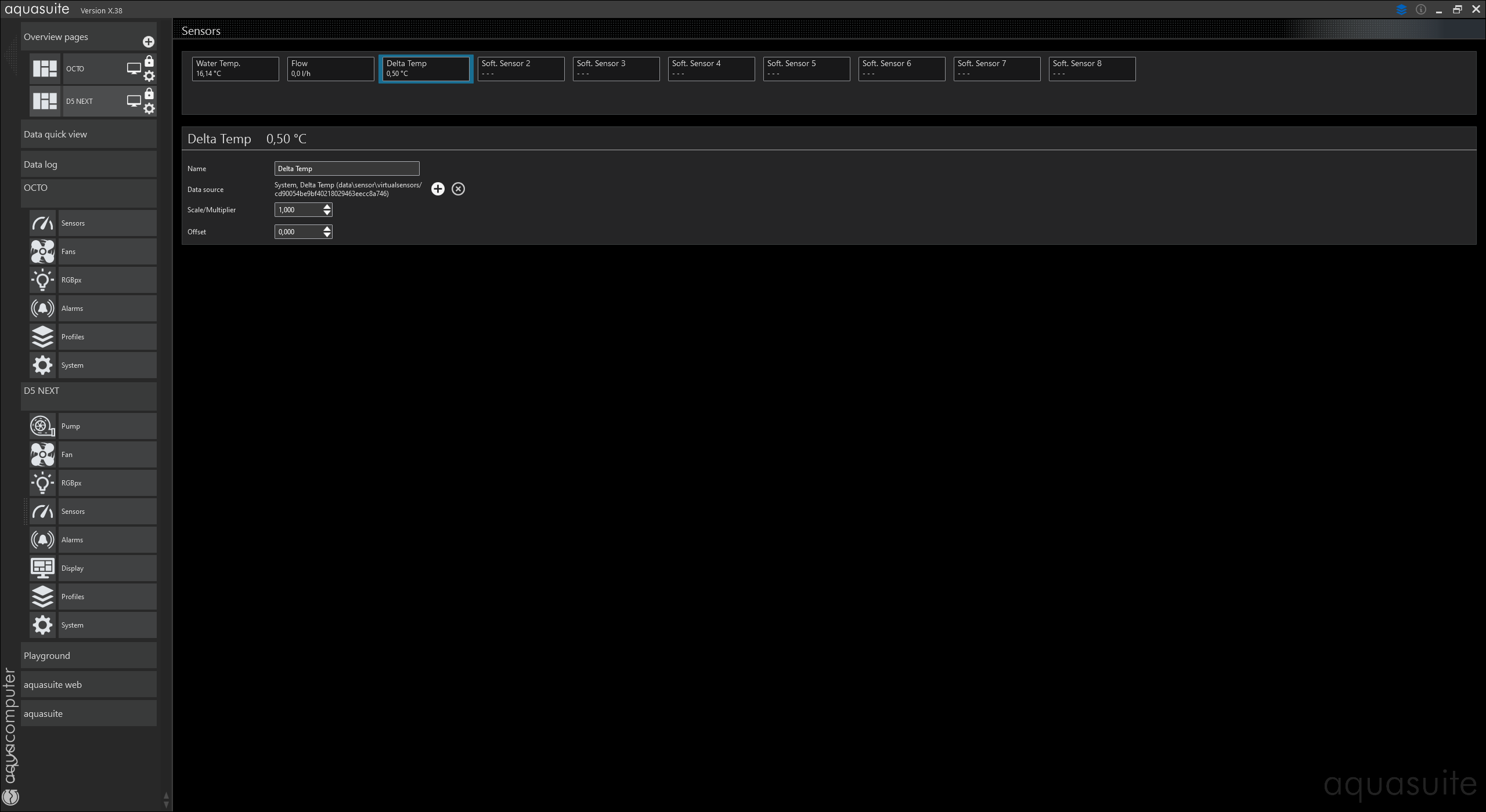

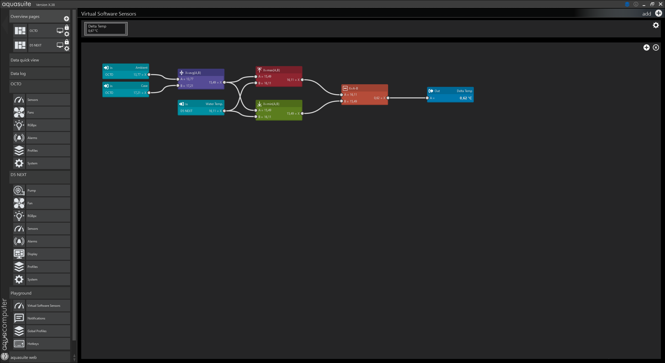

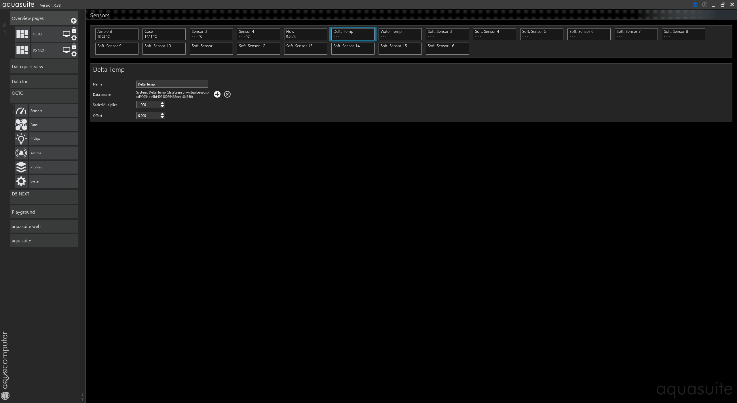

A week ago I've installed a new D5 Next in my system, and since then my Octo (inside Aquasuite) seems to be having some issues.
I can’t change to any of my Octo's profiles anymore and none of the software sensors have readings.
But, if I add the same sensor in the D5 Next I can see the value.
I've connected both USB cables to the same header, and for what I've checked my USB ports doesn't have 'USB selective suspend' enabled.
Also, I've restored each device to factory settings, removed Aquasuite X38 and installed it again, nothing seems to work.
Any thoughts what could be the cause of this?
Regards,
