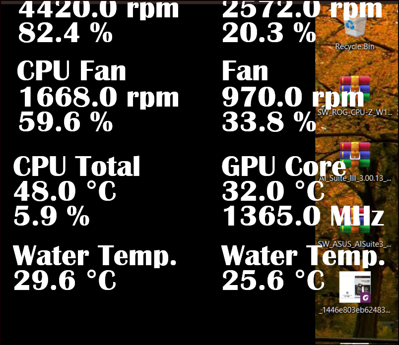

dimanche 19 janvier 2020, 19:02
Hello everyone
there are others who have problems with external senses,
I have been using aquasuite for a long time, since the beginning of January I find that external sensors shut down for a few minutes and come back
CoolMac a envoyé les images :
Ce message a été modifié 1 fois. Dernière modification effectuée par "CoolMac" (19 janvier 2020, 19:03)
