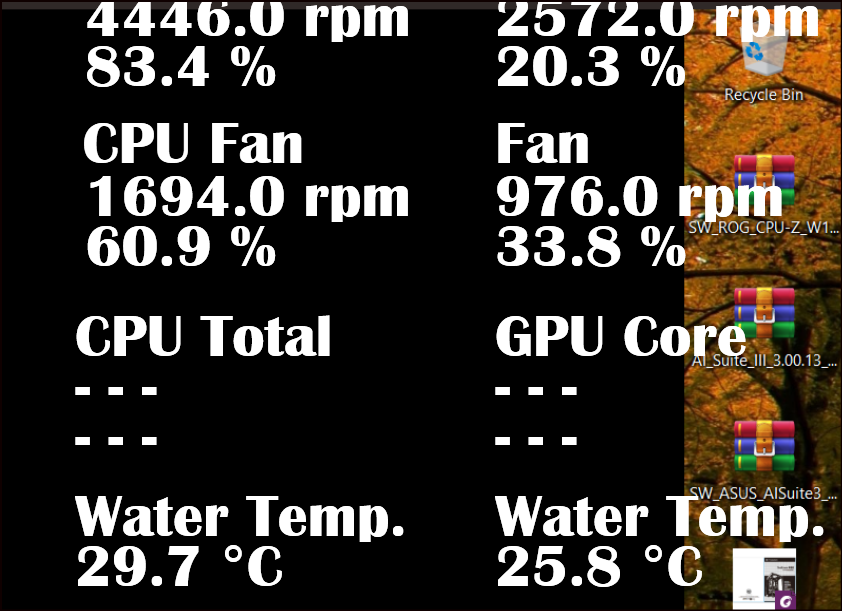

Aquasuite Version X11
Sonntag, 19. Januar 2020, 19:02
Hello everyone
there are others who have problems with external senses,
I have been using aquasuite for a long time, since the beginning of January I find that external sensors shut down for a few minutes and come back
